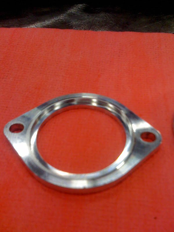

mklotz70 Posted December 17, 2008 Report Share Posted December 17, 2008 (edited) I thought Ice started a thread for this back when he did the welding thread....but I can't find it. If a Mod knows where's it's at, please combine them :) So, Ice asked me about using the rotary table on the mill. I figured, this way, I could put up more info without killing the Mend thread. Will the rotary make a perfect circle on the mill??? Basically, yes. It's not "perfect" compared to a lathed hole, but if you don't have a cnc to run the bed for you, it's the way to go. If you need a 3" or so hole to be really accurate, then you'd used a boring head like a did with the valve cover mod. You could use a rotary table for cutting down a hub to clear a wheel's inside diameter, but not to actually surface the mounting surface. Here's some pics of a perfect use for the rotary :) I didn't need the rotary for drilling the holes in the last shot, but being able to hold the parts in the jig was a lot faster and easier. If I had a ton of the tabs to do, I'd set up a stop(small clamp) on the vise and that would go even faster since changing the part would be faster. Since I have the digital readouts(DRO) on the mill, when I have the table set for center on the rotaty, I can set an SDM(sub-datum memory) with those positions ....x/y zero'd, then I can move the table to the vise if I want and then recenter the rotary. To recenter, you'd simply go to the SDM # you set for center and then dial x/y to zero I modified the tab jig a bit to make things go a lot faster. To finish off the holes in the tabs I countersunk the holes a bit. I countersink the first one to the depth I want, then turn the drill off...put the counter sink back down and set the depth stop.....now the rest of the tabs will get beveled to the same depth :) Edited December 17, 2008 by mklotz70 Quote Link to comment
mklotz70 Posted December 17, 2008 Author Report Share Posted December 17, 2008 So...for drilling the holes, the rotary needs to be centered, but for rounding off the ends of the tabs, only one axis is centered, the other is offset by the radius of the circle you are trying to make......in this case, it's offset to the side of the tab. Then the center of the rotary spins the part. If the tab were 1", the x axis would be offset by 1/2", plus half the dia. of the cutter(3/4 in roughing in this case). For what I was doing, eyeballing it to the side of the tab was close enough :) Hard to tell in the pics, but there's a plug in the the bottom of the tab jig. It is the diameter of the center hole on the rotary and goes into a hole in the jig. When I put the jig back on, the plug lines the jig back up on center of the table. I turn the slots to line up to the T slots and bolt it down. Since the hole for the plug is 3/4" and the cutter is as well.....I simply move the table until the cutter drops into the hole....then my table is centered and I can start making parts. Quote Link to comment
mklotz70 Posted December 17, 2008 Author Report Share Posted December 17, 2008 (edited) Here's some more detail on the plug for centering the plates for the counter boring operation. The marks around the edge are from when the cutter was too loose and got pulled down too far into the work. :( Normally, the top of the plug is well below the cutter and doesn't get touched. Basically, you do the same thing as with the tabs.....only it's the inside diameter you want. With the rotary centered on the y axis, the x axis will get moved to the radius you want, minus half the cutter. I think it's better for the cutter to cut with the side instead of the bottom, so I set the depth and leave it. Once the cutter touches the inside of the hole, I move the x some more to take a .020-.030 cut. I think I actually went up to .050, you just don't turn the table quite as fast. Since I had found the diameter I wanted first and set an SDM point for it, I was able to just keep moving the x as I rotated the table...a pass at a time. Move x in for the amount of cut you want, then rotate the table until the entire circumference is cut....then move x again, then rotate again. On a bigger mill, you might be able to cut the entire amount at one time, but the mill will flex with really heavy cuts....so I have to take 3-4 cuts where a Bridgeport could do it in one. By about the 3rd or 4th rotation, I was at zero on the x axis....so I finished the rotation and then moved the x axis so the cutter would be inside the hole again, lifted the spindle(which I have a caliper style dro on....changed out the part....dropped the z axis back to zero, moved the x until the cutter touched and started over again :) Since we're on the plates. ADrummond got me hooked up with the laser cutting, but he didn't think the holes would be clean enough. So, he made this jig and cnc'd them before I got them. He then gave me the jig. Now, I can clamp the jig to the table, find center on the plate(don't need to) with the reference hole. I can also find center on each of the three holes. If I save each as an SDM, I can go back to each of those positions for the next set of plates just be calling up each of the SDM's. For example.....if I find center on the first hole and set x/y at zero on SDM 100(it will hold 200 different points, so this is just an arbitrary number for an example), I can move the table all I want. I simply pull up SDM 100 again on the DRO and dial the x/y axis' to zero. Once they're at zero....I can drill hole 1 again. So if I set SDM's 100, 101, 102 for each of the holes, I can pull up 101 and drill hole two first if I feel like it. Anyway......... Edited December 17, 2008 by mklotz70 Quote Link to comment

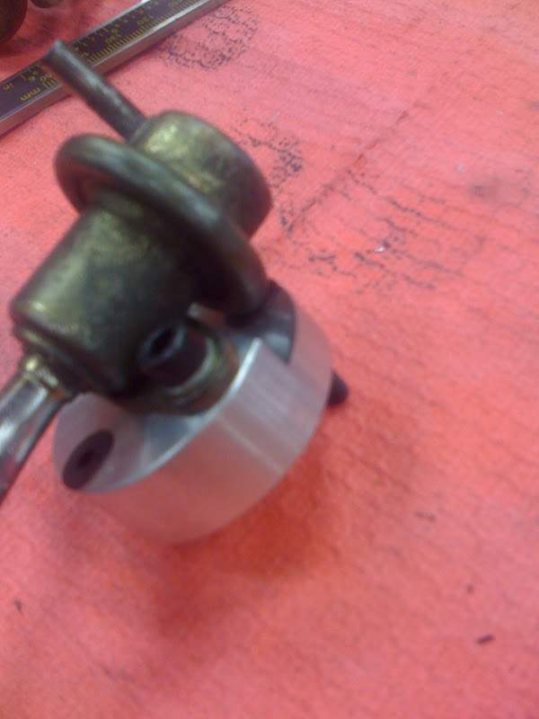

Icehouse Posted December 20, 2008 Report Share Posted December 20, 2008 Sweet!!!! Here are a few things I've built, I'm slowing learning how to be a machinist :D I really enjoy building parts though :D I built this guy to hold the pulley :D The pulley was super easy to turn down once I got to that step :blink: So much better than grinding a perfect circle!!! That little guy was a learning experience!!!! Anyone who has dual carbs on a dime will appreciate this!! stupid master cylinder :fu: Quote Link to comment
69FJWagon Posted December 20, 2008 Report Share Posted December 20, 2008 Anyone who has dual carbs on a dime will appreciate this!! stupid master cylinder :fu: Jeff did you cut it in half and machine the base to fit the shortned horn or did you make it in 2 pieces...either way they are cool Quote Link to comment
Icehouse Posted December 20, 2008 Report Share Posted December 20, 2008 Jeff did you cut it in half and machine the base to fit the shortned horn or did you make it in 2 pieces...either way they are cool I sectioned out an inch welded it back together then put it back on the lathe to smooth out the welds on the inside, it was almost impossible to tell it was even cut in the engine bay. I did it all for free for a buddy :D haha now I have to do another one... The next one is really thin so I hope the welding goes alright. I could of used green lock tight to old it together but I was afraid all the vibrations might brake it after a while, even though green lock tight is incredible strong once its dry I didn't want to take the chance. Quote Link to comment
