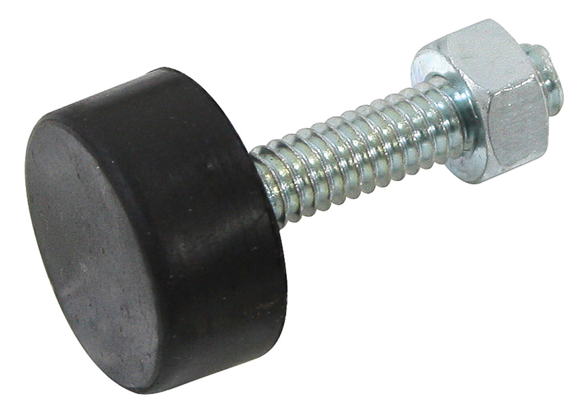

Get suitable size hose, about a inch long and screw it onto the ledge. Hood will close and crush into shape.
Go to wrecking yard and find a set of these and mount on the top of rad support...
Posted Image

Like rubber vaccum hose?  Screw that down?
And WTF are those?  What would I even be looking for in a wrecking yard to find them?
Ordered 4 hood bumpers from the Nissan dealer today.  $12.  Hopefully they work otherwise $50 from Thailand.
