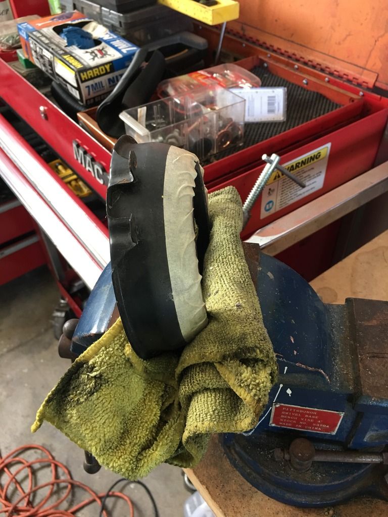

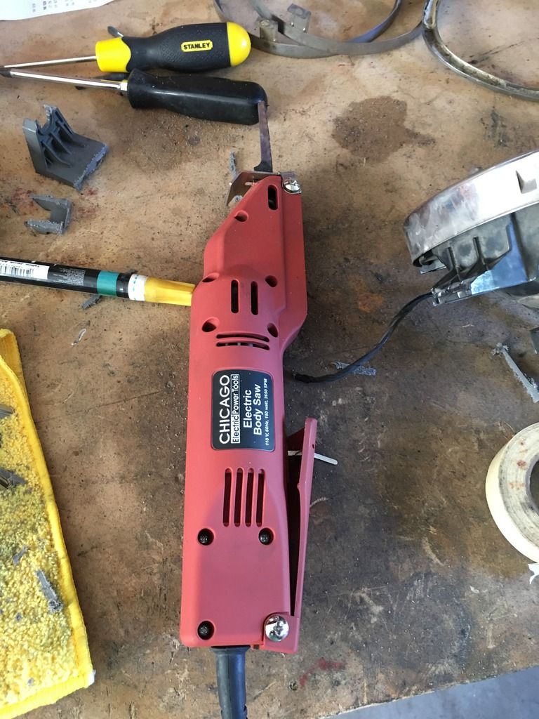

This tool made it easy to shave off the plastic pieces.

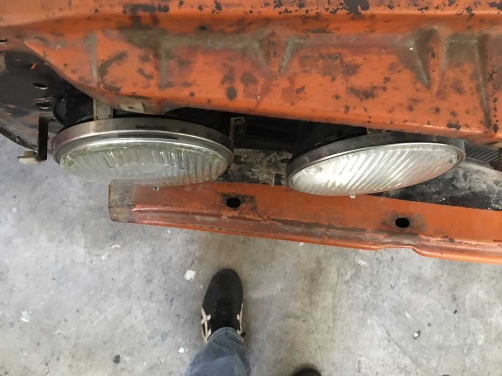

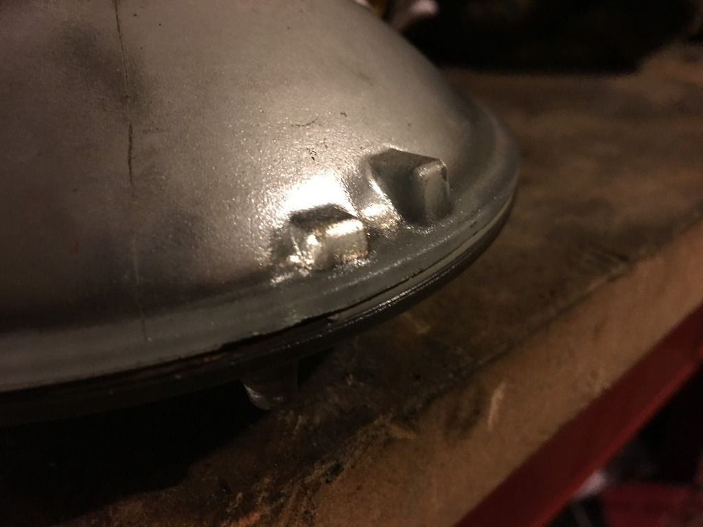

The high beam sits in loose with the retainer ring, that's because the OEM sealed beams have three little glass blocks that space the beam out enough for the retainer ring to compress it down and it also has three other glass blocks that prevents it from turning. For the next ones I cut, I will attempt and leave some plastic to work as the glass blocks do. Grrrr tedious work.

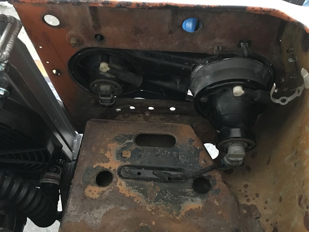

7.25" length space for a battery. I was thinking of using a miata battery but then I found a beefier one at the junkyard that might work and took measurements. 7.25" x 6.5" Walmart part number, VP-26 or VP-26R. They sell for $50 new with a 1 year warranty. 540 CCA.
I think I'm going to give it a try; I want HIDs and the miata battery might give me issues if I accidentally leave the lights on for a couple minutes.
