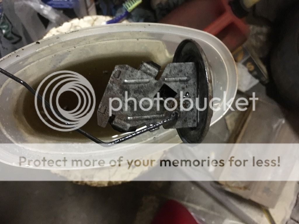

LenRobertson Posted June 11, 2017 Report Share Posted June 11, 2017 That came out pretty clean. My tank and unit after sitting looks just as clean as thT. The as why I can't figure out why my it doesn't register. I was wondering during if the temp and fuel work together cus I disconnected my temp to put a guage in I just went out to my '72 510 and pulled the wire off the temp sender at the thermostat housing. The fuel gauge still works fine. Both fuel and temp gauges are powered through the same gauge voltage regulator but each gauge then has its own ground wire out to its sender. The sender is actually a variable ground. The way to test your fuel gauge is unhook the wire from the sender at the tank. Use a jumper wire to hook the sender wire to ground. If the gauge is working properly it will read Full. Sparks won't fly when touching the sender wire to ground because it is actually a ground wire. If it reads Full when grounded but the gauge doesn't work when hooked to the sender, likely your sender is bad. Len Quote Link to comment
edekalil Posted June 12, 2017 Author Report Share Posted June 12, 2017 Sending unit seems to be fully functional. So I guess I'll clean the rest and see how it all goes. 2 Quote Link to comment

edekalil Posted June 16, 2017 Author Report Share Posted June 16, 2017 I think I will spray or coat this sending unit with some Tuf Glide not sure if it would help stop any rerusting of it but it should not hurt it. Now the question is do I use the old O ring that looks flat or get a new one. Any ideas what and where to get it? Quote Link to comment
