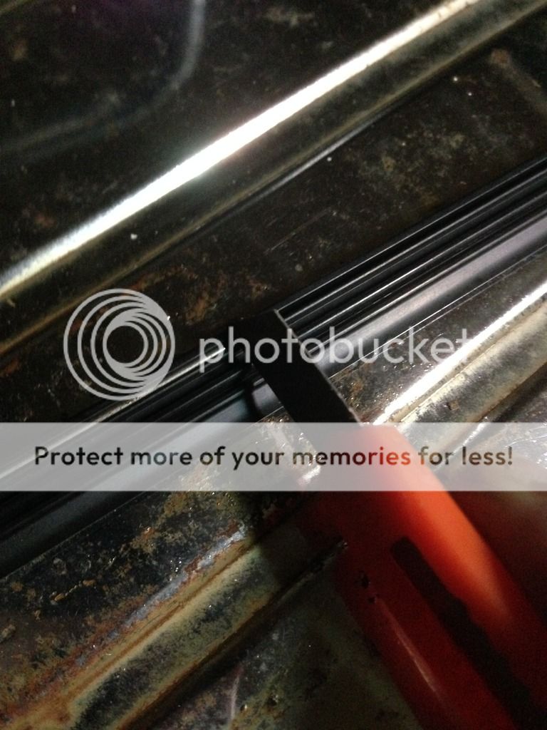

My wiper blades sucked ass so I trimmed down a 20inch set I had. 4D8C6B9F-913C-4B3C-96B7-3BBC489407C8_zps
Took the new blades apart and used just the rubber. 0BD106C0-8C4D-4C8D-BEA5-EE7989D19DB9_zps
Saved the metal strips from the old blade so it would line up with the old arm. 1B99EBFC-84EE-4E38-82BC-D8C99657EF7A_zps
Just trimmed it to fit and slid them in.067E60DC-A761-4EC3-998B-91897493F270_zps
I used needle nose vise grips to squeeze the metal past the prong to get it out.
Now I can drive in the rain and only deal with my bad windshield!!
