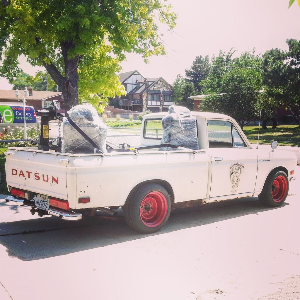

Thanks guys, yeah I got tired of taking them off then loading up my wheels & tires, driving to the local tire chain, paying for dismounting, mounting and balancing for my race and winter tires to be changed over again and again. It was always like $90-$100 a pop. I figure it'll pay for itself in no time! Plus I get to hook up family and friends! :rofl: Wheel weights are kinda expensive though...
