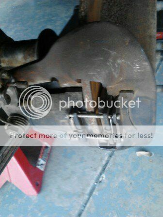

Well, Mannyvig pointed out to me that the bleeders are now on the bottom of the caliper so I need to use a pressure type bleed system.  I am also thinking about another set up all together......ideas anyone.
Datsunfreak: I see what you mean about the ebrake cable but I think it may just be the angle from which the oic was taken....just went out and looked at the passenger side and there is plenty of room.
I'm in the same boat with my 1200...   :rofl:
My current plan is to unbolt the caliper, slide it around to the "top" of the rotor, bleed it while holding it up there, then slide it back down and bolt it on.  :thumbup:
Of course you have hard metal lines, so...
Can you swap the caliper itself to the other side? Not the whole carrier/ebrake assembly, just the hydraulic bit in the center? Otherwise, yes. It's probably time for high pressure power bleeding. Now I see the reason why they wouldn't fit when I tried to mount them. I had them opposite of how you do, with the ebrake bit facing down.

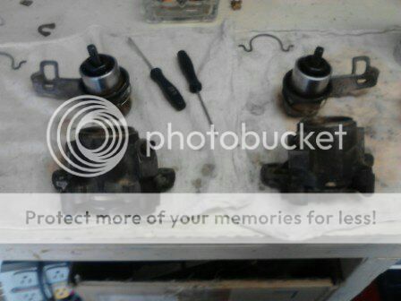

Well, posted those out of order....ah who cares.  So as suggested earlier, I decided to move the guts around.  Pulled the back half out of each side and presto(well it wasn't that fast), now I have calipers mounted to the rear.  Time to start moving towards the front.

Badass.  B)
Now I know how to fix that problem in the future...    :rofl:

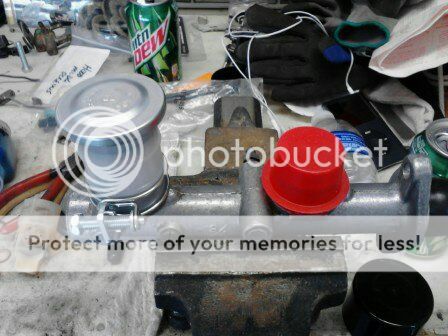

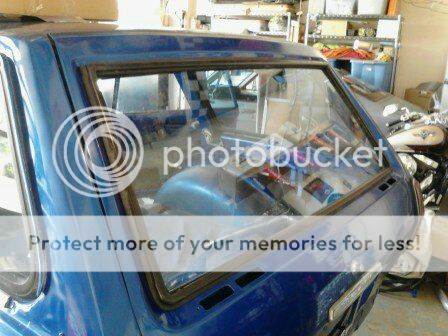

OK, little bit o progress today.....
glass installed
This is only the second time I have installed fixed glass ( with some help from the wife), always get a little nervous doing glass.

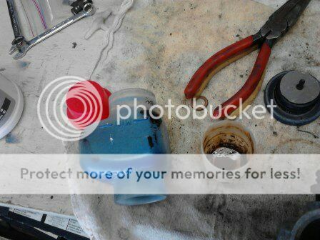

 A little brake master cylinder action
