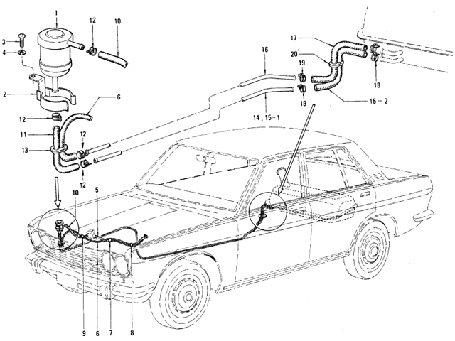

Posted 10 September 2012 - 05:55 PM
Posted Image
Ok this shows the top outlet on the tank as the return line. But does not show if this is the bigger or the smaller line. Google images has nothing............ANYONE have a pic of the two fuel outlets on the bottom of the tank so I dont have to pull mine out again PWEEEEEEEEEEESE.

Posted 11 September 2012 - 05:34 AM
It does seem weird but the larger is the return. Cooling lines for the automatic are also that way. It's to reduce/eliminate any chance of back pressure and appear to the fuel (or ATF) that there is an easy way back.
Posted Image
