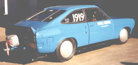

ggzilla Posted July 6, 2011 Report Share Posted July 6, 2011 World Record holder Datsun at Bonneville Quote Link to comment
RedBanner Posted July 7, 2011 Author Report Share Posted July 7, 2011 i like it too. but id lose the stripe down the hood i hate that stripe and im going to get rid of it asap. Quote Link to comment
RedBanner Posted July 7, 2011 Author Report Share Posted July 7, 2011 i like it too. but id lose the stripe down the hood i hate that stripe and im going to get rid of it asap.^^^ zilla thats a bad ass 1200 coupe. Quote Link to comment
