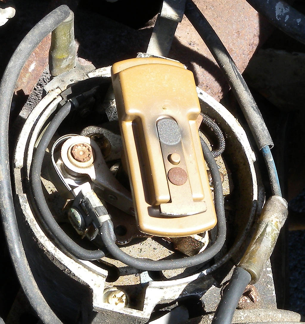

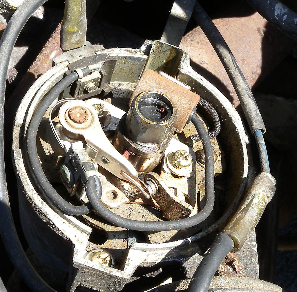

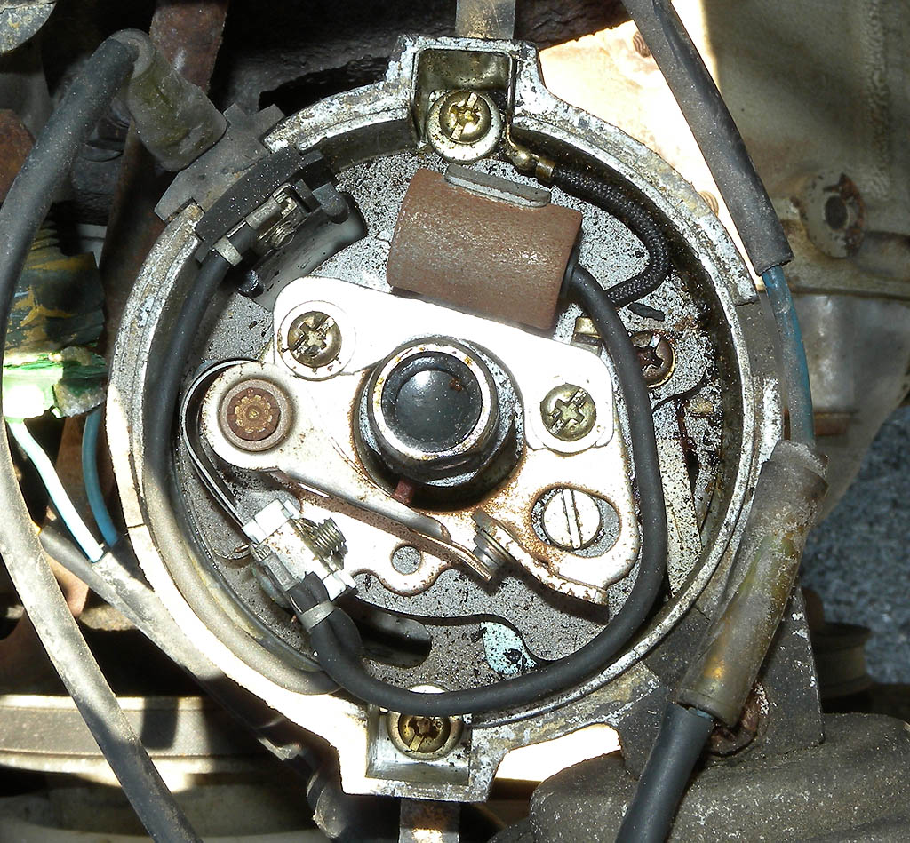

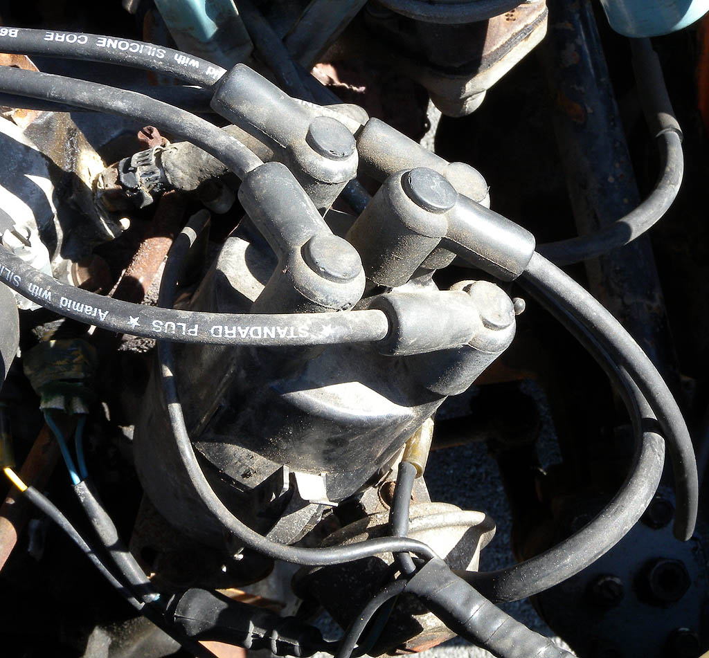

#11 g-mam
g-mam
  • Members
  • PipPipPip
  • 214 posts
  • Location:Winchester, VA
  • Cars:2008 Civic Hybrid, 2005 Pilot, 1974 Datsun Pickup, 2004 GSX-R1000, 2001 Shadow Sabre 1100
Posted 29 June 2009 - 01:37 PM
Photos I CAN DO! :)
Posted Image
Posted Image
Posted Image
Posted Image
Posted Image
Posted Image
Gary F.
My 1974 Datsun Pickup
#12 banzai510(hainz)
banzai510(hainz)
    L motor God
  • Senior Member
  • 15,058 posts
Posted 30 June 2009 - 05:23 AM
Yep
Yours is a bolt in for the Pertronix!!!!!!!!!
I say installe the Pertronix first with your stock coil and ballast to make sure it works fine. Then if you just got to use the pertronix coil then install it. I hope you got the 3 ohm Pertronix coil as that is what is recommended.
If using that you will route the blk/blu wire also to the +side as with the blk/wht.
But for now just do it stock.
Throw on some Weber sidedrafts, Rising Sun hood.... call it good
